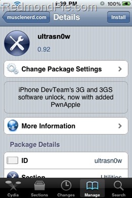

    Step 4: Once the repository has been added successfully, Search for “ultrasn0w” in Cydia and install this application. The latest version 0.92 of this app will automatically unlock your iPhone so that you can use it with any carrier with proper carrier name/logo.
    Step 5: Now simply restart your iPhone. Voila! You should now have a fully unlocked iPhone 3G/3GS on firmware 3.1.3.
