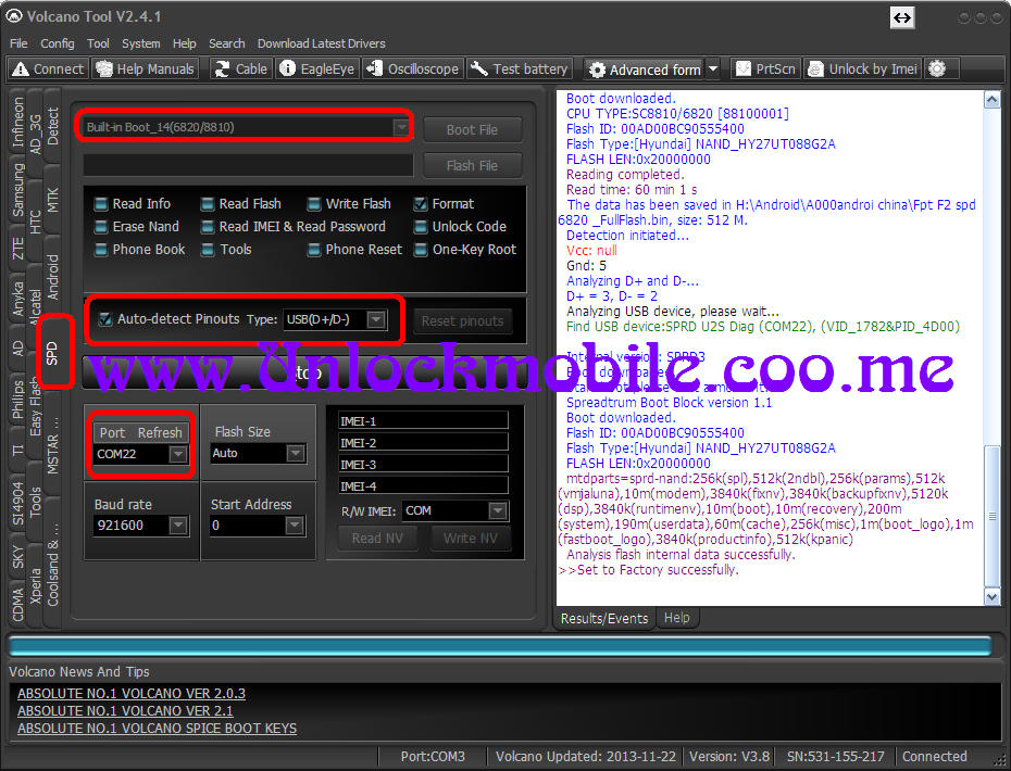

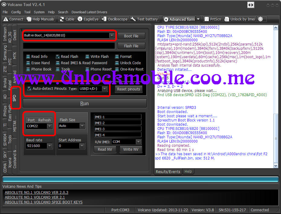

    Thêm dữ liệu cho AE múc mạnh em này , reset pass cứng không được nhé , flash tool thì thấy nhiều AE bị dính trắng màn .... Volcano ok hết :
    HTML Code:
    Code:
    Volcano Updated: 2013-11-22   Connecting...   Connection successful,connected state!   Version: V3.8   SN:531-155-217   Port:COM3   After format or Flash you have to press & hold power button for at least 1.30 mins.   Note for win7 users :   Start your Win 7 64bit with F8 key and choose 'Disable Driver Signature Enforcement'.   After that the spd drivers will have the ability to be loaded.   Available Ports:COM1 COM3    Detection initiated...   Vcc: null   Gnd: null   Analyzing D+ and D-...   Failed to detect.   Pinouts are not fonud!   Detection initiated...   Vcc: null   Gnd: null   Analyzing D+ and D-...   Failed to detect.   Pinouts are not fonud!        Waiting for phone's response, press the Power on the phone.     Detection initiated...   Vcc: null   Gnd: null   Analyzing D+ and D-...   User stop   Pinouts are not fonud!        Waiting for phone's response, press the Power on the phone.     Detection initiated...   Vcc: null   Gnd: 5   Analyzing D+ and D-...   D+ = 3, D- = 2   Analyzing USB device, please wait...   Found [SPD] USB device: SCI USB2Serial,(VID_1782&PID_4D00)   Setting...   Set the Pinouts failed,please reconnect and try again!   Detection initiated...   Vcc: null   Gnd: 5   Analyzing D+ and D-...   D+ = 3, D- = 2   Analyzing USB device, please wait...   Find USB device:SPRD U2S Diag (COM22), (VID_1782&PID_4D00)             Internal version: SPRD3   Boot downloaded.   Start boot please wait a moment....   Spreadtrum Boot Block version 1.1   Boot downloaded.   CPU TYPE:SC8810/6820 [88100001]   Flash ID: 00AD00BC90555400   Flash Type:[Hyundai] NAND_HY27UT088G2A   FLASH LEN:0x20000000   mtdparts=sprd-nand:256k(spl),512k(2ndbl),256k(params),512k(vmjaluna),10m(modem),3840k(fixnv),3840k(backupfixnv),5120k(dsp),3840k(runtimenv),10m(boot),10m(recovery),200m(system),190m(userdata),60m(cache),256k(misc),1m(boot_logo),1m(fastboot_logo),3840k(productinfo),512k(kpanic)   Analysis flash internal data successfully.   Detection initiated...   Vcc: null   Gnd: 5   Analyzing D+ and D-...   D+ = 3, D- = 2   Analyzing USB device, please wait...   Find USB device:SPRD U2S Diag (COM22), (VID_1782&PID_4D00)             Internal version: SPRD3   Boot downloaded.   Start boot please wait a moment....   Spreadtrum Boot Block version 1.1   Boot downloaded.   CPU TYPE:SC8810/6820 [88100001]   Flash ID: 00AD00BC90555400   Flash Type:[Hyundai] NAND_HY27UT088G2A   FLASH LEN:0x20000000   Reading completed.   Read time: 60 min 1 s   The data has been saved in H:\Android\A000androi china\Fpt F2 spd 6820 _FullFlash.bin, size: 512 M.   Detection initiated...   Vcc: null   Gnd: 5   Analyzing D+ and D-...   D+ = 3, D- = 2   Analyzing USB device, please wait...   Find USB device:SPRD U2S Diag (COM22), (VID_1782&PID_4D00)        Internal version: SPRD3   Boot downloaded.   Start boot please wait a moment....   Spreadtrum Boot Block version 1.1   Boot downloaded.   Flash ID: 00AD00BC90555400   Flash Type:[Hyundai] NAND_HY27UT088G2A   FLASH LEN:0x20000000   mtdparts=sprd-nand:256k(spl),512k(2ndbl),256k(params),512k(vmjaluna),10m(modem),3840k(fixnv),3840k(backupfixnv),5120k(dsp),3840k(runtimenv),10m(boot),10m(recovery),200m(system),190m(userdata),60m(cache),256k(misc),1m(boot_logo),1m(fastboot_logo),3840k(productinfo),512k(kpanic)   Analysis flash internal data successfully. >>Set to Factory successfully.

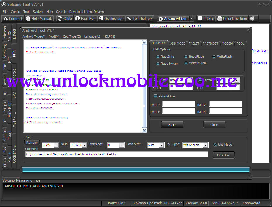

    >> AE lưu ý read usb bằng tool android của volcano hay bị đứng nhé ( chắc mới support nên chưa hoàn thiện )
    Vài hình ảnh em nó :
    Format :
    Đã text nạp thử ok không chết máy .... và text thêm cây Do-mobile I88 cũng ok hết

    flash tool múc f2 ok mà bác trắng màn flast lại lần nữa là ok

    hum nọ làm 1 cây cũng chíp này.mới mua vocalno lên không biết boot thế nào.mãi mới biết cách boot dòng này.

    volcano úp bản 2.4.1 read write spd 6820 được hết rồi hay chỉ read write một vài mode như bạn nói vậy , mấy con 6820 nay ghe quá , volcano mấy bản trước read done format ngỏm write file bakup không được , om hân lun .

    Có con flash tool 3 lần vẫn trắng bác nhé.....
    Mấy ver trước mình cũng có text ngủm 1 cây MTK ., flash tool thì cũng vậy .... vô tình có máy nhà kế bên giống nhau mượn read ra đạp vô bằng ver mới ok...
    volcano 2.3.9 hôm read con mtk6577 xong format ngỏm lun write file bakup vẫn ngỏm , qua china kiếm file úp tool mới hồi sinh , spd 6820 read ok nhưng write not ok với tool volcano 2.41
    Mình mới nạp MT6575 ok......volcano 2.4.1 nhưng nạp bằng tool android cua volcano

    hôm bữa bị thằng volcano này , read file cây q-smart s5 ok, format ngủm, Write flash lại không đc mới đau:L
